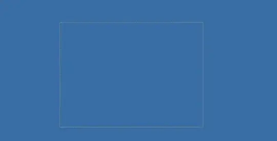

Is there a way to crop an image centered horizontally, but not centered vertically? For example, here is how I would want an image cropped:
expected
However, using the command mogrify -crop 250x250 -gravity North cat.jpg, I get:
gotted
Note I’m going to be doing this in a batch with around 10,000 images of different sizes, so I can’t explicitly pick an exact region to crop.
