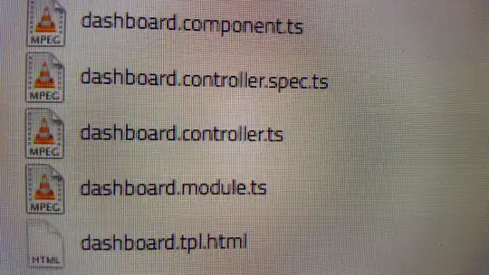

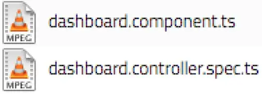

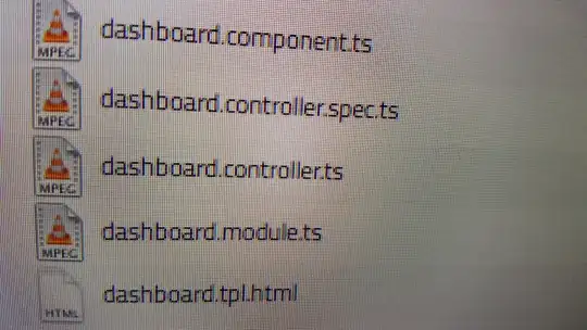

I've found out that when connected using HDMI instead of MiniDP, the rendering is improved. Unfortunately it only runs at 30Hz on HDMI, so that's not a solution. It may not be easy to see the difference when paying attention to the pixels, but the subtle difference makes a huge difference in readability during normal use. Open the pictures in full size using two different tabs, and flick between them, you should be able to see the difference. Can you see the hues around the edges of text? I think that's what's messing with my eyes.
I guess that's the subpixel antialiasing not working so well with MiniDP. I set AppleFontSmoothing to 0 to turn off subpixel antialiasing. Not much of an improvement.
I've tried 3 different DP cables, all with the same result. Any more ideas and suggestions?
HDMI - AppleFontSmoothing: 1 HDMI - AppleFontSmoothing: 1
MiniDP - AppleFontSmoothing: 1 MiniDP - AppleFontSmoothing: 1
Enlarged Screenshot - AppleFontSmoothing: 1 Enlarged Screenshot - AppleFontSmoothing: 1
MiniDP - AppleFontSmoothing: 0 MiniDP - AppleFontSmoothing: 0

  • The funky image modes make the colours terrible, although image quality is unaffected. There is no scaling at all, running at full 3840x2160 resolution. Just tried MiniDP 1.1, which runs at 30Hz only, and the image has *slightly* improved, although HDMI still looks better. I don't think it's to do with colour inaccuracy of the display to be honest, because again the HDMI image is better, and the difference is apparent when comparing pixel for pixel. Thank you for the thoughts. – Merott Nov 18 '15 at 00:12
