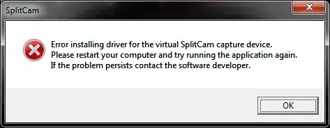

Error when I tried open SplitCam:

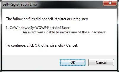

SplitCam error when repair it:
http://I.imagehost.org/0607/split.png
