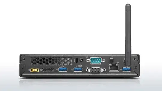

I actually did just this just the other day with a Lenovo ThinkCenter (tiny chassis). The DC power input connector is very similar to a USB plug (and I wasn't paying enough attention to what I was doing).
Lenovo tiny
In my case it corrupted the partition on a 500GB USB data drive I was working with when I accidentally yanked the power. Total data loss on that drive (maybe not total, but I decided it wasn't worth my time to try recovering the data).
