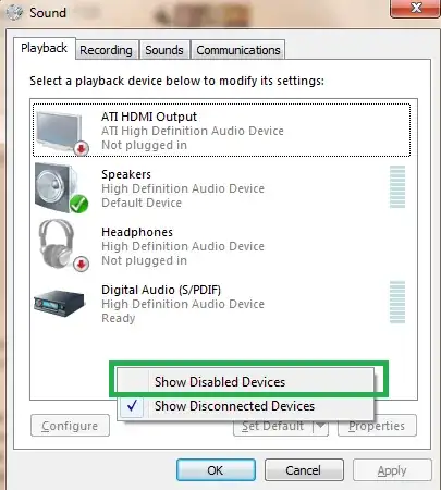

Same thing happened to me.
Click on speaker icon on the lower right hand side of your desktop:
Then click Playback devices.
Then Right click in the empty area of the list of devices, below all the rest of the devices, and click Show Disabled Devices:
Now you should see your disabled device:
