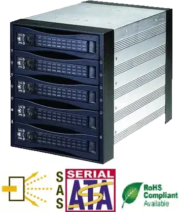

1 TB drives are pretty much history when it comes to mass storage (and i mean MASS storage :), 1.5 TB is currently the sweet sport for cost per GB and 2 TB drives aren't too far off either.
Get yourself some rack-mounting enclosures (like the one below, it can hold 5 3.5" HDDs), you can populate them as your collection grows.

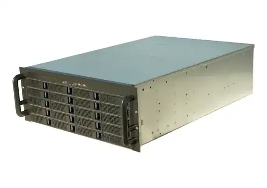

and here's a (industrial) Rackmount Chassis for 20x hot-swappable SATA drives ($350):

This solves the problem finding a "motherboard with "20 SATA connections" (the transfer rate up to 6 G will certainly suffice :) and you can connect them to any regular computer you wish to use as your Home/NAS server.
There are several Adaptec, 3Ware and Areca RAID controllers with 24 SATA ports available. Keep in mind that agreggating 20 drives mean you're having 20 times more chance of a catastrophic failure, so RAID-5 or RAID-6 really is mandatory.
You can also add drives to a RAID array with those professional RAID controllers. So my advice is to start with one of these and 8 drives, set up as a RAID6 array, that will provide you about 5.5 TB of effective space. Then grow as you go.
Keep in mind that mixing different drives (even of the same brand) may cause problems and kill performance.
Last but not least, the "desktop drives" have serious vibration interaction when put together in large stacks. Either use the more expensive "enterprise" drives, or use less bigger drives ( 8 x 2TB for instance).
Yes, there definitely have real reasons why storage enclosures, enterprise drives and RAID controllers are expensive. So be prepared to spend some serious money if you don't want to be riddled with troubles.
