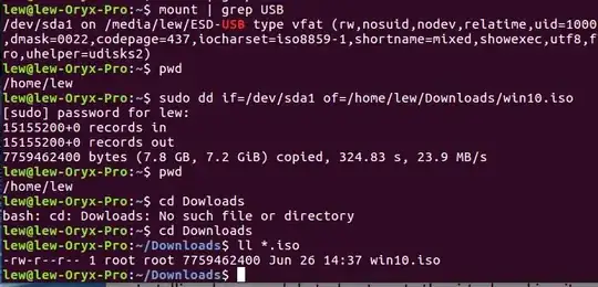

2 A couple of the dozens of articles yesterday talked about mounting. I don't remember where they are. I followed those procedures, and I thought I had mounted it to /media/external, but it shows up under /media/lew/ESD-USB.
Asking for files of /dev returned a lot of stuff but including sda and sda1 as below.
How do I tell what /dev is associated with my USB stick?
Can I specify a subdirectory in /Downloads for the output file? Will this command create a single *.iso file for vbox to target? As in:
sudo dd if=/dev/[something] of=~/Downloads/temp/win10.iso
After I install win10 from this, can I then delete the *.iso file to clean up?
Update 6/26 -- baby steps
So I think I found that the USB files above are associated with (mapped to?) /dev/sda1. Here's what happened next:

You could create an ISO file of the USB drive and then mount that in VirtualBox.
First, open a terminal by pressing Ctrl + Alt + T.
Then make sure VirtualBox is installed correctly by executing the following command:
sudo apt-get install virtualbox virtualbox-qt
You will be prompted to enter your password, once you do that, the installation of VirtualBox will start.
After this dd command, the rest of the procedure is probably the same as it was with Windows.
Make an ISO image of your USB drive by running:
sudo dd if=/dev/sdX of=/path/to/new.iso
Replace /dev/sdX with your USB drive, e.g. /dev/sdc (but not /dev/sdc1).
You can then use this ISO file as a bootable CD drive in VirtualBox to install Windows 10.
Remember, since this is cloning the entire USB, larger USB drives will take more time, so be patient.
