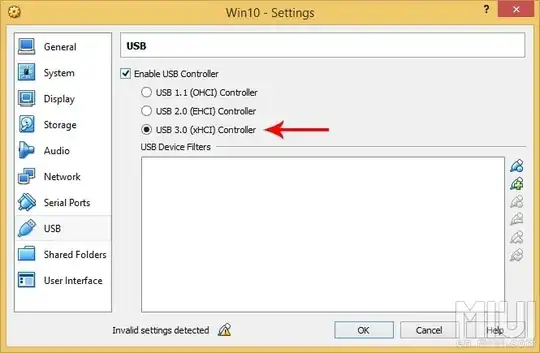

  3. Activate USB 2.0 or 3.0 in the Virtualbox Settings: Enable USB Controller. enter image description here
  4. Open System->Administration->Users, and select your user name. Click "Manage Groups", and scroll down to vboxusers. Click "properties", the make sure your user ID is checked. Re-start VBOX and USB should work. Source: Softpedia.
  5. Then you should be able to connect your Android device with the Windows in the Virtualbox and e.g. do the steps needed to unlock your XIAOMI smartphone.

    FYI, adding VirtualBox to a certain user group (I forget which exactly lol) is required in order for it to be able to access USB devices. – You'reAGitForNotUsingGit Jun 30 '18 at 12:46
    My Galaxy S8 required the use of Odin software which was only on Windows. But I managed to run it easily on my existing Windows 10 VM in Ubuntu, with USB passthrough as suggested. – Vijay Prema Mar 29 '23 at 00:57
