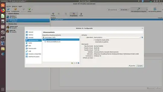

I have the latest Virtualbox 5.2.18 in a Ubuntu 18.04.1. I have a guest system Windows 10. I have a vmdk hard drive ( virtual drive) saved in a SSD disk ( the file .vmdk. So i have recently upgraded my system buying a NVME (Samsung SSD 970 EVO PCI-E NVMe M.2 500 GB). So i wanted to take advantatge and define the storage as:
But i get an error when i want to boot:
So but if i use the same file .vmdk as SATA ( which ive been using these past years and stored in a ssd disk) it works perfect...
I have also in both guest and host the latest Extension pack installed. Do i have to convert the file .vmdk ? Any additional files or missed things ?
This happens with others vm with a .vmdk virtual drive and .vdi also.
