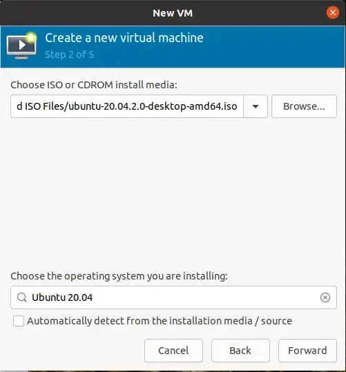

Open the app Virtual Machine Manager and go to File > New Virtual Machine:
We will use the Ubuntu 20.04.2.0 Desktop ISO. click Forward and proceed to the next screen:
Click the browse button and find the ISO file. Then click Choose Volume to select it. Fill in the Name of the OS you are installing as seen above.

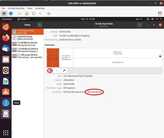

While still in the Live Try Ubuntu mode, open the disks app:
Make sure the Partition 1 and 2 are not mounted.Note the device names. In my case, Partition 1 is /deb/vda1 and Partition 2 is /dev/vda2. Yours may be different.
