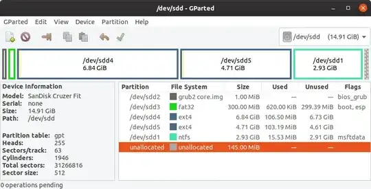

Creating a Full Install of Ubuntu 20.04 to USB that works in both BIOS and UEFI
Following is based on a 16GB Target drive, adjust for larger drive. This looks like a long list but, should take less than ten minutes to do the work.
  • Create a Live USB or DVD using SDC, UNetbootin, mkusb, dd, etc. (See Note 1 at bottom)
  • Turn off and unplug the computer.
  • Unplug the power cable from the hard drive or unplug the hard drive from the laptop. (See Note 2 at bottom)
  • Plug the computer back in.
  • Insert and boot the Live USB or Live DVD. (Booting BIOS mode preferred).
  • Select Language and Try Ubuntu.
  • Insert the target flash drive.
  • Start GParted.
  • Unmount any mounted partitions.
  • Select Device tab and create a GPT partition table on the Target drive.
  • Create a 3GB NTFS or FAT32 partition on the right side, (optional Linux / Windows data partition, See Note 3 at bottom).
  • Create a 1MB partition on the left side, format as unformatted.
  • Create a 300MB FAT32 partition next to the 1MB partition.
  • Create a 7GB ext partition next to the 300MB partition.
  • In the remaining space create an ext4 partition, (optional for /home partition).
  • Apply All Operations.
  • Flag the 1MB partition as bios_grub.
  • Flag the 300MB partition as boot,esp.
Image of GParted

  • Click Install now.
Image of  Something else
  • Confirm partitions to be formatted if asked, click continue.
  • Select your location. click "Continue".
  • Insert your name, computer name, username, password and select if you want to log in automatically or require a password. - Click "Continue".
  • Wait until install is complete.
  • Do not reboot or unplug the target USB.
  • Copy the boot and the EFI folders from the Ubuntu ISO file to the boot,esp partition sdx3.
  • If there any problems with permissions, etc, open Nautilus using sudo -H nautilus and try copying again.
  • Copy grub.cfg from partition sdx4 /boot/grub/ to partition sdx3 /boot/grub/ overwriting the grub.cfg file.
  • Re-Install GRUB:
    sudo mount /dev/sdx3 /mnt
    sudo grub-install --boot-directory=/mnt/boot /dev/sdx
  • Turn off computer and plug in the HDD.
