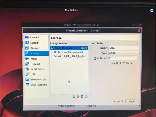

Did you try to press F12 at virtual machine startup to see the list of available drives? Did you try to choose W10 iso manually? Would you please post pictures of virtual machine system, display and storage? – FloT Jan 31 '19 at 23:16
Yes. The only one with anything on it is the disc drive. And sure – Mark Deven Jan 31 '19 at 23:17
Just in case - Ubuntu has a nice screenshot tool ;) – FloT Jan 31 '19 at 23:19
It’s a friends pc so I’m not logged in on there. Sorry it’s from a phone :) – Mark Deven Jan 31 '19 at 23:20
No problem, your pictures are good, I just thought it would be more convenient for you. On pictures, I see that Monitor count is set to 2 in display settings. May I suggest to switch to 1? And may I also ask for a picture of "storage" tab? – FloT Jan 31 '19 at 23:26
I tried both but sure – Mark Deven Jan 31 '19 at 23:27
Nothing shocks me in your settings... Did you try to start with only 1 monitor? Same result? Now I would suggest to check you ISO file. Did you have a chance to check it's integrity? For example with md5 checksum? Would you have an option for testing it on another computer/VBox? – FloT Jan 31 '19 at 23:42
