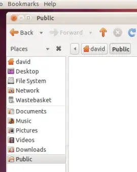

I think you are using the wrong keyboard layout. Open your launcher and search for keyboard layout. From there you should be able to add your keyboards layout to the list. You should set it as the default keyboard.
step 1
step 2
step 3
Incorrect keyboard mapping on Ubuntu under VirtualBox

  • @A.Adverse I've added some images that I hope help clear things up for you. – Jeff May 05 '19 at 19:19
    Thanks for the images, is there some way to do this from CLI the server has no GUI. VirtualBox is only running in a VNC session. – A.Adverse May 06 '19 at 09:31
  • The image I've added shows my VNC desktop. Until a recent "upgrade" it used to open a console as well. – A.Adverse May 06 '19 at 09:38
