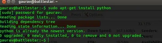

Its shows me error that I am not having python.But I am having that
Installing these application doesn't meet dependencies. The key point here is

To install ubuntu-restricted-extras type in terminal
sudo apt-get install ubuntu-restricted-extras
To install Python type in terminal
sudo apt-get install python
this should solve your problems in installing keryx
Here you can find a tutorial for keryx it states in simple steps how to do the job.
Ashu
  • 9,384
  • 37
  • 58
  • Link 2 tutorial for keyx is broken . and how come i install these package on computer without having internet. i am clearly mention this – twister_void Apr 30 '12 at 15:44
  • Srry for the broken link fixed it with a new link – Ashu Apr 30 '12 at 18:21
    The machine has no Internet access, so `sudo apt-get install ubuntu-restricted-extras` and `sudo apt-get install python` are not going to work unless the software being installed is available from some local package source. – Eliah Kagan Jul 17 '12 at 03:48
  • @EliahKagan what i understand from the question is that the OP's computer has internet but his friend does not. – Ashu Jul 17 '12 at 06:27
  • @Ashu You understand correctly. one system is having internet but the fresh install system don't – twister_void Jul 17 '12 at 10:47
  • @Gaurav_Java i dont think updates from one version (11.04) can be used for a different version (11.10/12.04) but still i'll try and find out. – Ashu Jul 17 '12 at 11:02
