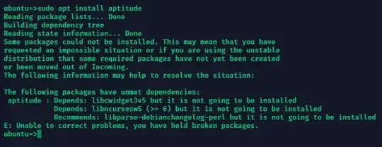

Then install aptitude.
sudo apt install aptitude
