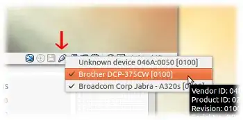

Shut down your virtual machine and open USB settings in the VirtualBox Manager. Tick Enable USB Controllerand USB 2.0 (EHCI) Controller or USB 3.0 (xHCI) Controller.
If these settings are greyed out, you need to shut down the virtual machine.
4. Select host USB device for access from the guest
To grant access to USB devices we need to select a device to disable in the host and to enable in the guest (this is a precaution to avoid simultaneous access from host and guest). This can be done from the panel Devices menu or by right mouse click in the bottom panel of the VirtualBox Manager on the USB icon:
Tick the device you need in the guest, untick it if you need it in the host. If you can't see your USB device in that list, it means that VirtualBox cannot access your host USB devices. Make sure your user is added to the vboxusers group and that you restarted your host.
The selected device will immediately be accessible from the guest. A Windows guest may need additional drivers.
