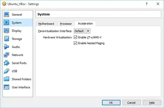

I am running Virtual Box 5.0.0 r101573 on Windows 7 Enterprise SP1. Ubuntu 15.04 has the problem listed, which went away after I unchecked Enable Nested Paging.

This message appeared in my VirtualBox while I was installing/starting Ubuntu 15.10. (The same problem occurred for previous versions as well.)
Solution
  1. Restart the host computer.
  2. Go into the BIOS settings.
  3. Enable Intel® Virtualization Technology (Intel® VT).
  4. Save the BIOS configuration and reboot.
  5. Start VirtualBox.
  6. Press Ctrl+S or right click on your guest OS and click Settings.
  7. Go to System -> Acceleration.
  8. Check Enable Nested Paging.
Acceleration settings
Boot the Ubuntu guest, and voilà it works without any problem.
