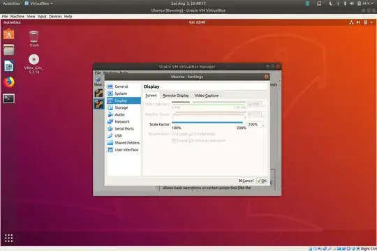

The scale factor in the virtual machine settings did the trick for me. I set it from 100% to 200%.
Note: I have a Huawei Matebook X Pro.

All I had to do was go into the guest OS's display settings and change it to maximum resolution. (Make sure in the VirtualBox settings that you don't have it set to a maximum width of about 600px).
View image here
