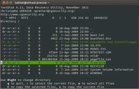

  8. Press P to list files on that partiton.
  9. Browse to the directory containing the data. View the filenames to make sure you did choose the right ones.
  10. Select directories or files to harvest using : . All selected files/directories will be marked green:
  11. Press upper case C to copy all selected directories/files to the rescue directory which will be selected in the next step.
  12. Choose a directory on your Ubuntu VM's mounted partition(s) to hold rescued data:
  13. Press c to start copying the data from the broken .vdi to our rescue directory in your healthy VM.
