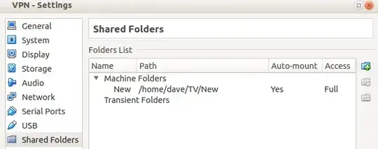

I am trying to share a folder on my host system so that my guest system can write files to it. I've followed instructions as best I can, installed the Virtualbox guest additions. I've got to the point where I've added the shared folder in the Devices interface:
shared folder
However, even after rebooting, I can't find the folder anywhere in my guest system.
