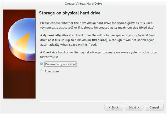

I'm not sure you can. However, you can create a dynamically allocated VHD instead.
Here is how to create it:
Click settings, and then Storage and click Controller: SATA. Then click the Blue square with a green +.
Click Create new disk:
Chose VHD and click Next:
Chose Dynamically allocated, and click next:
Chose a name, a size and click Create:
You will be able to install Kubuntu on this, it detects it as a full sized HDD. And don't worry about wasting space with the old VDI - you can either remove it, or just ignore it - mine is 3.1 MB.
