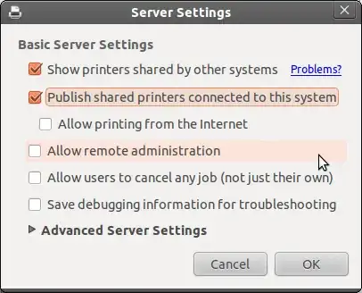

Go to the Settings Option in the Server Menu in the Main Menu above:
Step 2
Activate the first 2 options so that the CUPS server knows that you will be sharing a printer in the network and looking for shared printers. This will solve two problems, one problem is when clicking on the sharing option inside the printer's configuration window will message an error saying "Not Published. See Server Settings". Since the server is not configured for sharing, this is the reason why it is not published in the network and even if you have it marked as shared, it will not appear on the network. The other problem it will also solve is the problem of other network connected PCs not finding the printer.
