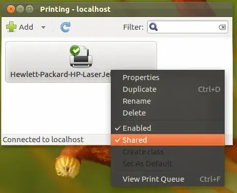

I don't have your exact setup, but this will get you going in the right direction, if you get stuck just update your question. You need to enable printer sharing:
In this case the computer connected to the printer will be the "Ubuntu print server", so just follow the directions in that part of the document.
  1. On the server machine (the one the printer is attached to), open System -> Administration -> Printing. This will open the Printer Configuration window. OR you can open the following URL in your browser: http://localhost:631
  2. Select Server in the menu bar, and then Settings. This will open the Basic Server Settings window.
    1. Check the second box: Publish shared printers connected to this server
  3. If this computer acts as both a Print Server and a client (it does need access to a printer connected to another computer), select also the first box, "Show printers shared by other systems".
After that just right click on the printer and select "Shared":
