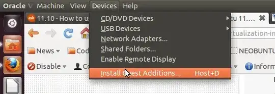

  1. Load the Guest Addition ISO from the Virtualbox Menu
  2. In the guest Ubuntu open a terminal and install some essential files for the Guest Addition to install correctly:
    sudo apt-get install dkms build-essential linux-headers-generic in my case of 32Bit
  3. Run the Linux Guest Addition installer in the Guest Ubuntu. Open the terminal, cd yourself to the mounted image (In my case is cd /media/cyrex/VBOXADDITIONS_4.1.6_74713). In your case you need to input cd /media/USER/VBOXADDITIONS_VIRTUALBOX_VERSION where USER is your username and VIRTUALBOX_VERSION is the current version you are installing. After that run the Guest Addition:
    sudo ./VBoxLinuxAdditions.run (It is in the root directory of the ISO image)
  4. Since you installed the needed packages in step 2, you should be fine after installing the Linux Addition since it will configure with no problems. Say yes to a question or two it might ask but this will not do you harm since it will be checking to see if you have the guest addition installed already. Reboot after finishing the install.
  5. Now when the guest starts again you should see that you have several new options available like input devices, views, etc.. but the one you are needing is SHARE FOLDERS!!. To share a folder you already know that is done from the Virtualbox Menu.
  6. But what we need is to connect to this Shared folder from the Host. To do this first create a folder in the guest which will link to the shared folder from the host. For example lets create in the guest home folder the directory virtual. Now assuming the shared host folder is also called virtual we would set this up in the guest like this:

  • You can also do the Guest Addition setup from the Proprietary Driver Manager. That is, jockey-gtk As seen in this picture (This is the same as Step 2)
After all of this you should have a Virtualbox that shares folders with the host and back and has 3D acceleration. Here is an image of the outcome:
