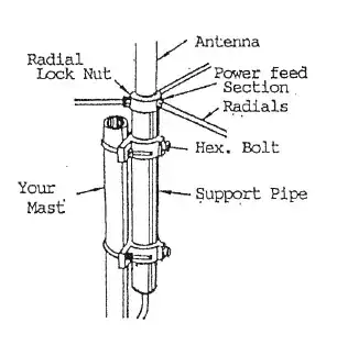

Regarding the overlap of the mast to the antenna, there should be about 1 foot of overlap as shown in this picture:
The top of the pipe must stay below the decoupling radials in order for the antenna to function properly. This puts the top clamp within an inch or so of the top of the pipe.

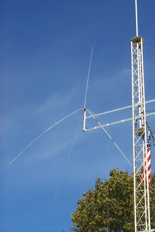

I would say the mast must extend only high enough to provide appropriate mechanical support. Glenn W9IQ provides a great illustration.
Having the mast extend above the antenna might provide some degree of lightning protection since the mast, rather than the antenna will take most of the strike current. But I'd regard this as a "nice to have" rather than a requirement. In the case of installing a vertical on the mast you'd need to get the antenna horizontally away from the mast. Sometimes you see this on towers, like this one on the KA1RCI repeater network:
However, given you have just a small mast rather than a huge tower, I'd say this is just unnecessary complexity and cost with very little benefit. Instead, I'd recommend following good lightning protection practices.
