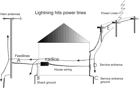

have only a single point of entry to protected equipment
Perhaps the most neglected point of all. If there are multiple points of entry, that means lightning current can enter at one point, and exit at another. As discussed in the previous point, lightning currents are so huge that they make significant voltage gradients almost everywhere, including between the two points of entry to your station. Where there are voltage gradients, there are currents, and where there are currents, things break.
A very common situation in amateur stations is to have a grounding rod at the mast or tower, where the feedline enters the shack, or both. W8JI provides a great diagram of a poor grounding system:
poor station ground configuration
(I highly recommend reading through the rest of W8JI's lightning and grounding information. Lots of diagrams, pictures, and good advice. On this topic: Ground systems, House ground layouts, and Second floor grounding.)
When lightning strikes the power lines, some of this current will go to ground through the additional ground(s) at the tower or shack entrance. After passing through your equipment and frying it, of course. Strikes on the tower cause the same problem, in the other direction. This is a situation where a naïve attempt at protection has made things worse, virtually guaranteeing equipment damage when a strike occurs. Even a nearby strike might introduce enough of a voltage between the grounds to cook your equipment.
Worse, in some setups, disconnecting the feedline leaves this extra ground (B) still connected, violating the popular "wisdom" that disconnecting the feedline in a storm protects your equipment!
