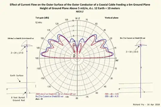

Below is a NEC4.2 study of the effects of r-f current flow on the outer surface of the "grounded" outer conductor of a coaxial transmission line connected to an unbalanced antenna.
A true r-f ground does not exist at the top of an unburied conducting path whose base is connected to a true r-f ground (e.g., Earth). Any r-f current flowing on that conducting path produces e-m radiation for the same reasons it does when flowing on the antenna conductors, themselves.
Richard Fry
