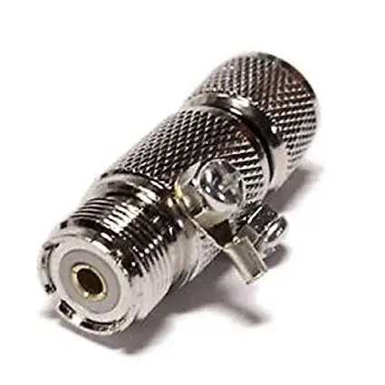

Here is what is advertised (and recommended by Elmers in my ham club) to connect your coax to a local ground. It is called a Lightning Arrester.
It has an internal spark gap that will only be jumped by a high voltage coming in from your antenna.
There is no direct connection that will have any effect on the antenna, as long as this on at the near end of the coax, and not right at the antenna.
Lightning Arrester
They are available from the usual sources.
I recommend grounding this the same place your radio chassis is grounded. That way this is nothing but a pass-through connector with an internal spark gap.
SDsolar
  • 2,059
    That little screw terminal alone will provide effectively no lighting protection at all. By grounding this to a water spigot, etc, you are creating a low impedance path between two ground rods which will not be at the same potential when there's a nearby strike, a low impedance which goes through your equipment. This is a recipe for bad times. – Phil Frost - W8II Apr 02 '17 at 12:38
  • How could it go through the equipment when it will only jump the internal spark gap during a strike? – SDsolar Apr 02 '17 at 20:45
    It won't jump *just* the spark gap. Do you think that puny terminal lug and that teeny spark gap will really contain an entire lighting bolt? And what about the non-zero impedance of the connection to ground, and of the soil? Why would all the current go through that ground lug, especially when the wire attached to it is much smaller and thus higher impedance than the coax shield? How will this device help with the difference in potential between two ground rods: one at the electrical panel, another at the antenna? – Phil Frost - W8II Apr 03 '17 at 13:28
