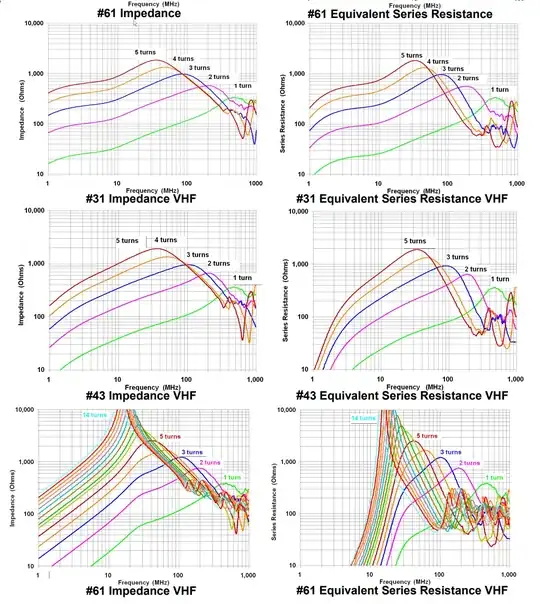

The K9YC paper you mention gives data up to 1 GHz on page 49:
These data show for these core types the maximum number of turns is just one or two. Furthermore, it's quite difficult to achieve a choking impedance above 1 kΩ. That's not very much, and for many applications you'd want more.
To get a higher choking impedance will require a larger core, and so ferrite chokes can become quite expensive at higher frequencies. For this reason it's often worth considering other techniques to supplement or replace them.

  • As much as I like this answer --especially correcting my misinformation-- I think there is more to it. I get the impression that smaller cores, in addition to making more efficient use of ferrite, have higher resonant frequencies. So to get a higher choking impedance, maybe it is sometimes advisable to use a smaller core along with a smaller wire (and 5-10 turns as per Laird). There was something along these lines in one of Snelling's books (either _Ferrites for Inductors and Transformers_ or _Soft Ferrites, Properties and Appications_).but it did not sem important at the time. – Chris K8NVH Apr 15 '18 at 21:08
    As a postscript... I bought some small (0.125 inch ID) ferrite beads in #61 and #43 to see if the number of turns might be higher for any given frequency. They were not. Curves were close to what was posted here. – Chris K8NVH Jul 26 '18 at 02:04
  • A single turn is max? Is this why they frequently stack the beads on the wire? – user10489 Jul 26 '18 at 11:26
  • @user10489 A single turn is the max at VHF, so stacking a lot of beads is the only way to get more impedance. But when it's done at HF, I guess some people just have too much money. Or possibly they need (or think they need) a very wideband balun. – Phil Frost - W8II Jul 26 '18 at 11:50
