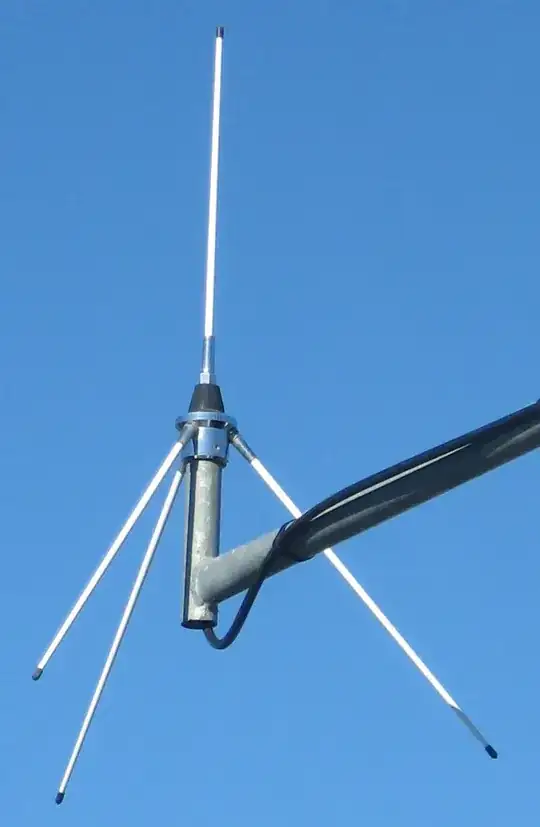

One approach is to keep the system unbalanced all the way. If you have an unbalanced coax feedline, then put an unbalanced monopole antenna on it.
By F1jmm - Own work • Self-photographed, CC BY-SA 3.0, Link
The three drooping wires are the "ground plane". Drooping them increases the feedpoint impedance from the 37Ω of a monopole on a flat ground plane to 50Ω for a better match. Since the ground plane presents a very low impedance to the ground currents, that's where most of the current will flow. The coax common-mode is a relatively high impedance.
