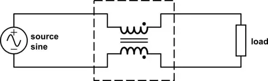

This is a common-mode choke:
schematic
simulate this circuit – Schematic created using CircuitLab
Common-mode current sees a high impedance, and is thus "choked". (Of course there's nothing drawn in this schematic which would introduce such a current, but the real world is not so simple.)
If you put a common-mode choke in a box with a coax connector at one end and screw terminals or some other balanced connector at the other end, you've made one kind of balun. It's 1:1 (because it performs no impedance transformation) and a current balun (because with high choking impedance, common-mode current approaches zero). And while theoretically there may be other possible designs for a 1:1 current balun, in practice "1:1 current balun" means "a common-mode choke with balanced and unbalanced connectors on it".

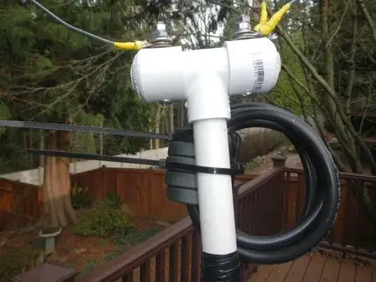

Currently, on my 80-meter dipole, I run 450 ohm ladder line to a 4:1 Current Balun and the remaining 20 feet or so is coax into the shack. In this application, I experimented with both a 4:1 and a 1:1 balun to find the best match and overall SWR on my bands of choice I use with this antenna: 80, 40, 30.

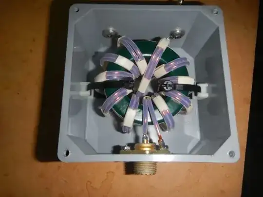

With the same antenna, I have used my own custom made choke balun made from coax turns through 6 toroids -- about 7 turns of coax through all 6 toroids. This worked very effectively except for one thing. This balun was heavy and often would be a factor in my antenna coming down in a wind storm so I replaced it.
So, in answer to your question specifics: (1) they do not always perform the same function but sometimes they do; (2) A regular current balun internally is very much like a transformer where as a choke balun usually focuses on multiple turns through toroids to provide high-impedance to common mode currents; (3) the names are different and some people distinguish between one thing and another by the names and others do not. It is usually not a big deal from my experience unless you are buying something but then you look at the data sheet to understand the balun better.
The image below is of one of my custom made choke baluns. This is an older one that used only five toroids.
The following image shows one of my current baluns, a 1:1 5 KW balun.
