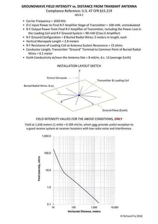

Below is the output result of a NEC4.2 analysis of an electrically short monopole, showing its near-field boundary radius to be located about 30 meters from the base of that monopole.
The groundwave field beyond about 30 meters decays at nearly a 1/r rate, but not exactly 1/r because of the surface wave propagation losses present for these conditions — even for the short path shown.

    I am struck by the apparent difference in our answers. Any idea how to resolve this, Rich? – Glenn W9IQ Aug 17 '18 at 01:50
  • Most likely because the distance to the radian sphere (r = λ/2pi) defines the boundary limit where the reactive power density from an "infinitesimal radiator" is greater than its radiated power density [Source: Antenna Theory, Analysis and Design, 2nd Edition - C. Balanis; §4.2.3(d)]. That radius for the NEC model posted above is about 29 meters. Thanks for asking a technical question. – Richard Fry Aug 17 '18 at 11:47
