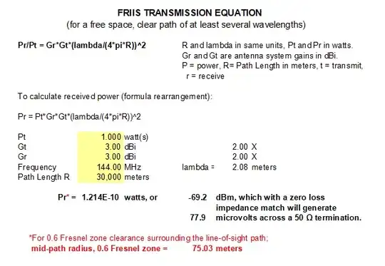

Below is the output screen of a spreadsheet calculator using the Friis equation, displaying received r-f power based on transmit/receive system parameters when using a free space propagation path. Numeric values in the yellow-shaded cells may be entered by the user.
The spreadsheet also automatically calculates and displays
- the mid-path radius distance for clearance of the 0.6 Fresnel zone, as such Fresnel clearance provides the propagation loss of a free-space path
- the r-f voltage present across a 50 Ω output termination of a loss-free matching network at the receive antenna output terminals.
This Excel-type spreadsheet is available at https://nofile.io/f/19jUxxDHCJE/Friis+Transmission+Equation+Speadsheet+(Fry).xls — free to download and free to use.

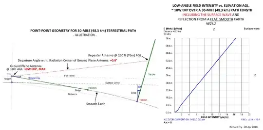

Next below is a graphic illustrating the effect on the e-field produced by insufficient clearance for the Fresnel zone with various heights above ground of the receive antenna, for the conditions shown there.
