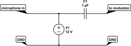

Condensers require a source of power to bias the capacitor, and in practice they must also include a buffer to convert the high condenser output impedance to something appropriately low for a long cable. It often takes the form of a simple FET integrated with the microphone capsule. Rather than running another pair of wires just to power the microphone, it's common to use the same wires to deliver power by employing a bias tee:
schematic
simulate this circuit – Schematic created using CircuitLab
This circuitry would be inside the radio so a microphone can simply be plugged in without additional components. The capacitor serves to block DC while allowing AC (the audio signal) to pass. In this way the circuitry inside the radio can bias the audio signal to whatever voltage is required by the design, independently of the bias voltage to power the microphone.
By adding another series capacitor to the left of V1 you're blocking the bias voltage from reaching the microphone. In the case of a dynamic microphone this is important, since the coil of a dynamic microphone looks like a short to DC. As such your microphone would become a heater, then a smoke machine, then a paperweight.
However, this would also block the bias voltage necessary to run a condenser microphone.
