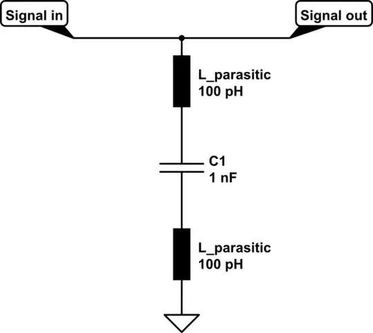

The reason to use a bypass capacitor instead of a simple capacitor to ground is that you'd typically want to keep the series inductance to ground as low as possible. So take this model of a capacitor with parasitic series inductors:
schematic
simulate this circuit – Schematic created using CircuitLab

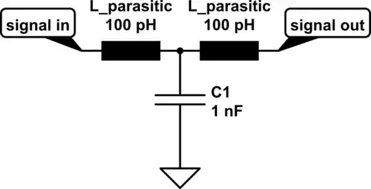

and make it something more like this:
schematic
(values not representative and also not equal between forms)
Leaded capacitors really have a problem acting as pure capacitor at high frequencies, simply because the leads have a high degree of inductance themselves.
Therefore, elegant engineers came up with capacitors that you simply "wrap" around your signal line and "insert into ground"; your photo shows an excellent example of that. An example data sheet of different kind of three-terminal capacitors can be found here.

  • Wouldn't it be more appropriate to model the parasitic inductance as an inductor in series with each leg of the capacitor? And when you model this lumped element at HF frequencies, how significant is the inductance to the desired bypass effect? – Glenn W9IQ Nov 27 '18 at 19:54
  • @GlennW9IQ you're absolutely right; can't find a good primary source, so go with this, please: https://www.murata.com/~/media/webrenewal/products/emc/emifil/knowhow/20to22.ashx (page –18–). – Marcus Müller Nov 27 '18 at 20:52
  • Wouldn't it then be appropriate to update your answer? – Glenn W9IQ Nov 29 '18 at 00:44
  • huh. I must have been tired. Here you go! – Marcus Müller Nov 29 '18 at 10:44
