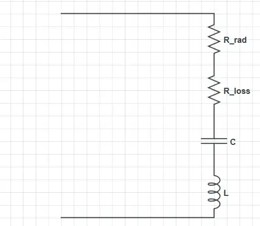

You can the behavior of an antenna with circuit model. The simplest circuit model for a resonant dipole would be a series RLC circuit. The circuit model transforms all impedances as they are seen in the feedpoint of the antenna. With the circuit model of the figure, the radiation efficiency becomes: $\eta = \frac{R_{rad}}{R_{rad}+R_{loss}}$, where $R_{rad}$ is the radiation resistance (power radiated to the far field) and $R_{loss}$ is loss resistance (power transformed to heat). $C$ and $L$ represent the reactive fields near the antenna.
Circuit model of $\lambda/2$ dipole near resonance.
OH2FXN
  • 968
