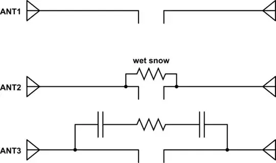

A heavy coating of ice or snow is likely to short the feedpoint of the antenna. Compare:
schematic
simulate this circuit – Schematic created using CircuitLab
Even if the wires and feedpoint are protected by insulation and the ice isn't directly touching, a thick coating of ice will make a tube around the wires, and the resulting capacitive coupling is a low impedance at RF. (ANT3)
Snow or ice isn't a great conductor, but it's a much better conductor than the air or PTFE insulator that was between the halves of the antenna. Clearly the antenna impedance, and thus the SWR, will be affected.
