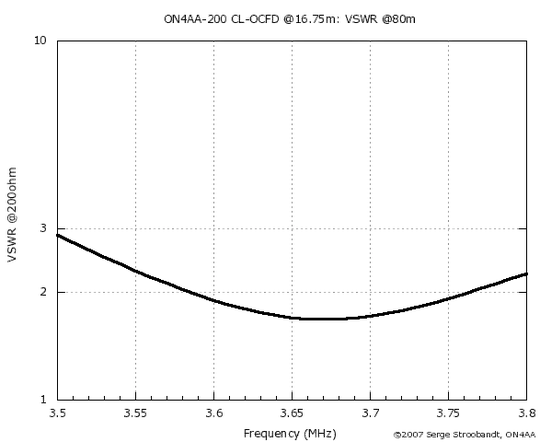

Resonant off-center fed dipole (OCFD) antennas exploit this effect by being fed at a higher input resistance $R_\text{in}$ from a source with a higher internal resistance $R_\text{source}$. Consequently, OCFDs achieve much broader bandwidths at their fundamental resonant frequency than their center-fed counterparts.
$${Q_\text{loaded}\downarrow}\equiv\frac{X_\text{in}}{R_\text{in}\uparrow+R_\text{source}\uparrow}\quad\textrm{and}\quad Q_\text{loaded}=\frac{f_\text{res}}{BW}\quad\Rightarrow\quad{BW\uparrow}\,=\frac{f_\text{res}}{Q_\text{loaded}\downarrow}$$
For example, here is a graph of the 80m VSWR bandwidth of my multiband CL-OCFD.
ON4AA CL-OCFD 80m VSWR bandwidth
