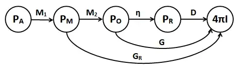

Not really answering the question but requesting more clarity in terms.
From the IEEE definition of standard terms for antennas: I redraw the diagram of power flow in an antenna, (ignoring the polarisation mismatch branch)
Antenna gain
Where:
$P_A$ = power available from the generator
$P_M$ = power to matched transmission line
$P_O$ = power accepted by antenna
$P_R$ = power radiated by antenna
$I$ = radiation intensity
and
$M_1$ = mismatch between generator and line
$M_2$ = mismatch between line and antenna
$G_R$ = realised gain
$G$ = gain
$D$ = directivity
$\eta$ = radiation efficiency
The above "loss" terms on the straight line each have a physical explanation:
Directivity is only affected by the geometry of the antenna; how it concentrates power.
Radiation efficiency is only affected by losses in the metal and the dielectric.
The first part of the question is really about what type of antenna has the highest $\eta$ given real-world materials. I can think of a few but would have to simulate to be sure. A dipole is a good start. A travelling wave antenna like an (unterminated) rhombic or very long dipole might be better, they have smaller standing waves.
The second part of the question, "why", is harder to answer, because it might not be possible to reduce the physics of the antenna to a simple explanation. It will certainly involve $Z_0$ of free space but I don't think there will be a direct relationship between that and antenna impedance.
