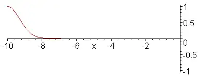

From a wave mechanics perspective, when current initially begins to flow at the feedpoint of a dipole into one of the legs, it travels along the length of the wire until it hits the open end of the dipole. Because the wire has a finite thickness, there is a small amount of self capacitance present at the end. Since this capacitance does not present the same impedance at which the current was flowing, it forms an impedance discontinuity. Any impedance discontinuity forms a complex reflection coefficient that sends (in this case) all of the current traveling in the opposite direction.
Credit to http://physics.usask.ca/~hirose/ep225/animation/reflection/anim-reflection.htm
Once this reflected current reaches the feedpoint of the antenna, the current standing wave pattern on the antenna fully is established. It has a near sinusoidal shape.

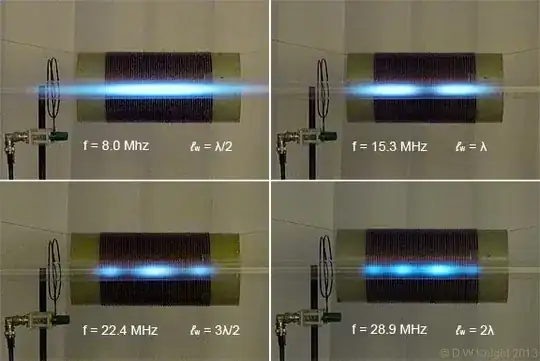

Then just when you start to get a grasp on the wave mechanics, it turns out that the inductor itself can have standing waves along its length. Here is an interesting lab picture from Dr. David Knight that shows a wave traveling along an inductor is reflected at the impedance discontinuities that occur at the ends of the wire of the inductor. The picture shows a gas discharge tube in close proximity to an inductively excited coil:
This suggests that a more rigorous analysis should include any standing wave effects associated with the trap itself.
