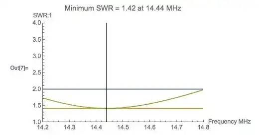

I have used NEC4 to model the antenna parameters used by Phil Frost in his answers. I am doing this primarily for my own curiosity to see how close or far apart his answers from his algorithm are from the NEC4 modeling of the same antenna.
The antenna being modeled is a center fed dipole, 10-meters total length, with #12 copper wire. The only difference between the previous answer and mine is that Phil Frost used 3 mm for the diameter of the #12 wire and I am using 2.053 mm which is a value I get from this web-site: American Wire Gauge.
My first run is for a FREE-SPACE solution and the only thing I am showing at this time is the computed SWR plot.
20 meter dipole SWR
The plot is generated from Mathematica using the following procedure:
  1. Run NEC4 on input data to produce solution output file.
  2. Scrape output file to produce curated data file.
  3. In Mathematica, read curated data file.
  4. In Mathematica, create Interpolation Function on data to compute SWR.
  5. Plot function.

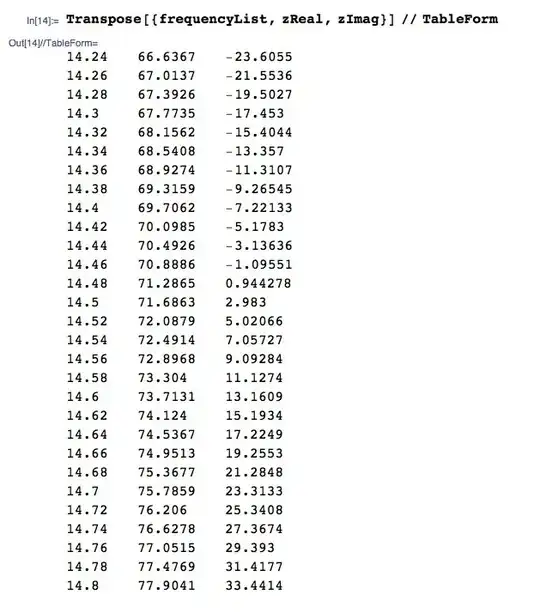

The data used is the antenna input impedance calculated by NEC4 versus a standard 50-ohm RG-8X coaxial cable made by CableXperts (using their data). The actual data computed is shown in the table below. The three columns left to right are frequency, real value of impedance, imaginary value of impedance.
The above plot shows the SWR minimum of 1.42 at 14.44 MHz. The minimum is marked by the yellowish-orange horizontal line. On my SWR plots I always mark the SWR 2:1 horizontal line as the bandwidth that I am interested in is between the intersection points of the SWR curve and the 2:1 SWR horizontal line. Other people may use other SWRs to determine bandwidth (such as 3:1).

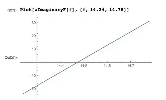

The resonant frequency of the antenna is when the impedance is a pure resistance. This occurs when the reactance, the imaginary value, is zero. The following plot shows where the reactance crosses the zero value at approximate frequency of 14.475 MHz.
The frequencies below the resonant frequency have negative reactance values meaning that these are capacitive reactance. Capacitive reactance indicates that the antenna is too short for those longer wavelengths. Given that the resonant frequency of 14.475 MHz is outside of the 20-meter amateur band, a better antenna solution would demand a longer antenna than the 10 meters as modeled.

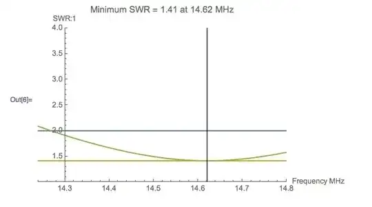

The following plot shows the SWR of the same physical antenna but this time it is modeled over a real ground profile using a Sommerfeld/Asymptotic solution implemented by NEC4. The elevation of the antenna over ground is 10 meters. The key ground parameters are conductivity of 0.004 siemens/meter and a relativity permittivity of 12.
Notice that the minimum SWR is now slightly lower than before and the frequency where minimum SWR occurs has shifted slightly to a higher value.
