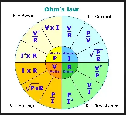

In a flat 450 ohm line, there is significantly less current in the conductors than in 50 ohm coax. Therefore, the I^2*R losses are significantly lower as compared to commonly-used coaxial cables. The size of the conductors in each has a bearing on this.
Ohm's law (chart below) tells us that as we increase the impedance, the voltage increases while at the same time the current decreases.
