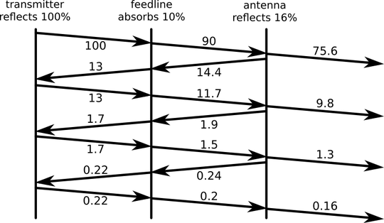

Let's say for our example the VSWR is 2.35:1. That's a reflection coefficient of 0.4. This is a ratio of amplitude or voltage, so square it to obtain power: 16% of power is reflected, and the other 84% is accepted by the antenna.
And let's say forward power is 100 W. Furthermore, we'll assume the transmitter contains a tuner. When the tuner is adjusted so the transmitter sees a matched load, effective the tuner is inserting an impedance in the line which cancels the reflected wave, so the transmitter doesn't see any reflected power. Since the tuner (neglecting losses) has no resistive components to absorb any power and convert it to heat, this must mean all the reflected power that reaches the transmitter is reflected again back towards the antenna.
Now let's visualize what happens to that power as it reflects back and forth a few times.
Sum all the power that was accepted by the antenna (75.6W + 9.8W + 1.3W + 0.16W + ...) to explain how much of that 100W was accepted by the antenna, and the rest was lost to the feedline. Shown in the diagram, a total of 86.8W makes it to the antenna. That means losses were:
$$ 10 \log\left(86.8 \over 100 \right) = 0.61\:\mathrm{dB} $$
Through more iterations we can obtain a more precise answer, but you can see that after a few reflections the powers have become small enough to be negligible.
