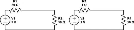

I figure the transmitter has a 50-ohm pure resistive output
Not necessarily. You're probably arriving at this conclusion based on the maximum power transfer theorem. Which of these circuits delivers more power to the load resistor?
schematic
simulate this circuit – Schematic created using CircuitLab
What we can say is the manufacturer has designed the transmitter expecting a 50 ohm load, and they've also designed it to minimize their cost, thus maximizing their profit. This means when the load is 50 ohms the transmitter will be able to make its rated power while staying within the ratings of the components of the transmitter, the finals especially. But there won't be much margin for deviation, because that would increase costs.
When the load isn't 50 ohms this might subject the finals to too much current, voltage, or power. If we're lucky this means the radio just reduces power. If we're unlucky the radio doesn't reduce power, and the finals are damaged.
So we want the transmitter to see 50 ohms so it can operate as designed.

  • As usual you gave me a whole more to think about. I was wrong about the bottleneck situation because I was thinking in terms of a parallel resonant band-stop filter, when actually the antenna/tuner combo is more like a series resonant band-pass filter. The two circuits you posted really threw me for a loop. For some reason it doesn't seem fair to change the source impedance and compare them. Can I instead look at it as 50Ω source and 2500Ω load? I would see it as more efficient since most energy is dissipated in the load versus source but overall less power is transferred because of higher Ω. – pgibbons Sep 13 '21 at 17:08
  • and please help me out with this basic math, the way I calculated your circuits: A: 1V divided by 100Ω = 0.01A, then looking at the 50Ω load * 0.01A = 0.5W. B: 1V divided by 51Ω = 0.02A, looking at the load, 50Ω * 0.02A = 1W. So that tells me B transfers more power but because of different source impedance is that apples and oranges, am I getting this correctly or what am I missing? – pgibbons Sep 13 '21 at 17:13
  • @pgibbons There are many ways to analyze the circuit but I'd calculate the current by dividing 1V by the sum of the two resistances, and then you can calculate the power in each resistor with $P=I^2 R$. The efficiency is $R_{load} / (R_{src} + R_{load})$. So, efficiency is maximized by minimizing the source resistance. Of course maximum efficiency isn't the only design criteria, but the point is there's no reason the source impedance must be 50 ohms, and there are reasons you might not want it to be. – Phil Frost - W8II Sep 13 '21 at 17:59
  • I can't believe I screwed up the watt calculation lol (cry) and thank you for teaching me. My correction: A (left): 0.005W, B (right): 0.02W, so B gets more power. If I do source=50 and load=2500 (apples to apples i think) then 0.0004W and then A gets more power. – pgibbons Sep 13 '21 at 18:51
  • @pgibbons well it all depends on your definition of apples, I suppose. But even in your example of 50 and 2500 ohms, you'll find that case delivers a higher fraction of the total power to the load and is thus more efficient, even if the total power delivered is less. You could construct two circuits which draw the same current from the power supply, or deliver the same power to the load, and compare them in a similar way; in all cases, decreasing the source impedance will increase the power delivered to the load and increase efficiency. – Phil Frost - W8II Sep 13 '21 at 18:57
