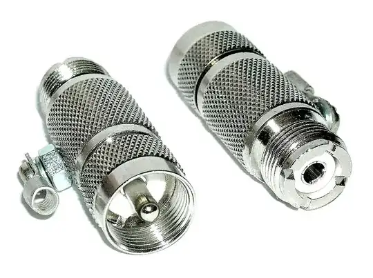

You could also use a lightning arrestor type device and connect the ground tab to the fence:
Make sure to waterproof this connection. At the same time, I would eliminate the connection to your gas pipe ground wire.
Doing this will change your antenna from an end fed, vertical wire to something closer to a vertical antenna with a ground plane (with the fence as the ground plane). This should give you a more favorable directional pattern.
