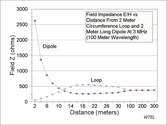

You can build different antennas which, at some distance in the near-field, have a different sensitivity to one type of field or the other. W8JI has a good article on small loop antennas, and describes this in some detail. In particular, there's this great graph:
dipole and loop impedance vs. distance
A high impedance means the antenna is more sensitive to electric rather than magnetic fields. So, you can see that if your noise source is very close (less than 10 meters for this antenna) and is largely E-field noise, you'd want a loop.
However, keep in mind:
  • the impedance of all antennas are identical and equal to the impedance of free space (377Ω) in the far-field. This only makes a difference for noise sources in the near-field, which couple to your receiver by mutual inductance or capacitance, not EM radiation.
  • the impedance changes up and down in the near-field with distance, and if a particular antenna seems to have less noise, it's due to chance and your particular noise source's characteristics, not some magical "noise immunity" intrinsic to some antenna design.
That said, most people already have dipoles, so if they find them noisy, sometimes they have luck switching to a loop, which provides a complementary near-field impedance, and just might be better in a particular environment.
