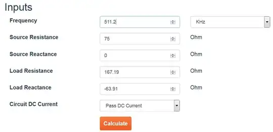

For example, let's use this calculator. From the data in your question, we enter the following information: enter image description here

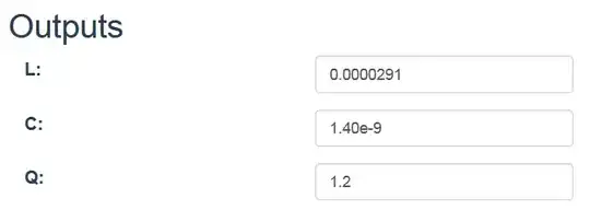

which produces the following results: enter image description here

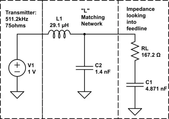

Your matching network looks like this:
schematic
simulate this circuit – Schematic created using CircuitLab

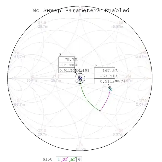

Using SimSmith to plot this transformation on a Smith chart: enter image description here
shows that the L-network provides a nearly perfect match to your transmitter.

  • @BrianK1L1. Looking through your information, I wanted to be sure that you (And I) are understanding the parameters correctly. 1st-I am not a ham person. I do not have a transmission rig. This antenna is only for receiving AM signals to an AM radio. 2nd-The above measurements were captured at the point where the receiving signal would enter the AM radio, not at the antenna end, because the “transmission” is actually from the antenna to the radio. So, does this not affect the spoken “network of inductors and capacitors”? And therefore make the "matching" network diagram backwards? Yes? – B. Varner Apr 03 '19 at 19:51
  • @BrianK1L1. Because of my last comment above, should the entries into the calculator not change? INPUTS: Freq=511.2, Source Resistance=167.17, Source Reactance=-63.91, Load Resistance=75, Load Reactance=0. This produces OUTPUTS: L=2.91e-8, C=1.40e-12, Q=1.2 ?????? – B. Varner Apr 03 '19 at 21:08
