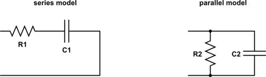

Nearly all of these things are just the antenna impedance, expressed a different way.
Why for Z & Zpar are there 2 numbers, one with a j in front. What do those mean?
Z represents impedance. It's essentially the concept of resistance, but extended to work for AC circuits. Impedance is a complex number, which consists of two parts. The first part is a real number, and is the resistance. The second part is an imaginary number which represents reactance, which accounts for the effects of things like inductors and capacitors. The j is the imaginary unit, which is just part of the notation for writing imaginary numbers.
What is the difference between C & Cpar?
One way to represent an impedance is to come up with an equivalent circuit made of resistors and capacitors that would have the same impedance (though only at the single frequency tested). That can be done as a series or a parallel circuit:
schematic
simulate this circuit – Schematic created using CircuitLab
$C$ is the value required for the series circuit, and $Cpar$ is for a parallel circuit. The RigExpert doesn't give a value for the resistor, because that's just the first part of the impedance, either Z or Zpar for the series or parallel circuits, respectively.
In some cases you will see the rigexpert report $L$ and $Lpar$ instead, this means the capacitor should be swapped for an inductor.
What is the difference between Z & |Z| & Zpar?
$Z$ is just the resistance and capacitance of the series equivalent circuit above expressed in a different way. Rather than give the value of the capacitor (or inductor) required in farads (or henries), it gives the impedance, which is the resistance plus the reactance. Calculating the reactance of a capacitor is just some simple math:

Zpar is just the same thing, but with Cpar instead. I would note this notion of "parallel impedance" is a bit of mathematical nonsense specific to the RigExpert. Because impedance is a single number, just one impedance can't be arranged "in series" or "in parallel". Zpar does tell you the equivalent parallel resistance, and the reactance of the equivalent parallel capacitor, but adding these numbers together doesn't make sense because parallel impedances don't combine by adding. Rather, they combine like parallel resistors: the reciprocal of the sum of the reciprocals. And you will find the result of combining the equivalent components in parallel yields the (actual) impedance given as Z.
$|Z|$ is the magnitude of $Z$. Other terms for the same thing are the "modulus" or the "absolute value".
What is rho?
It should be the reflection coefficient, which is just yet another way to express an impedance, but which also takes into account a characteristic impedance which the RigExpert is going to assume is 50 or 75 ohms, depending on the settings.
From the numbers you've provided, it looks like your RigExpert is currently set to 75 ohms, and there was an error in transcribing the magnitude which should be 0.45, not .045.
