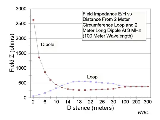

Paradoxically, at some intermediate distance which isn't very near the antenna, but is also not far enough away to be in the far field, the situation reverses. W8JI has this great graph:
If the vertical axis were logarithmic, these two antennas would each have a field impedance that's the mirror of the other. This is an example of duality.
You asked specifically if loops have reduced sensitivity to atmospheric noise, and the answer is no. Since such noise is in the far field of the antenna, a dipole and a loop will perform identically if all else (efficiency, polarization, feed arrangement, height above ground, etc) are equal.
However especially on HF, there can be quite a lot of noise in the near field of the antenna. Since the near field impedance of these antennas are quite different and complementary, it is often the case that a loop does not pick up the same noise sources that a dipole does.
