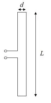

As explained by antenna-theory.com:
Figure 1
Typically, the width d of the folded dipole antenna is much smaller than the length L.
Because the folded dipole forms a closed loop, one might expect the input impedance to depend on the input impedance of a short-circuited transmission line of length L. However, you can imagine the folded dipole antenna as two parallel short-circuited transmission lines of length L/2 (separated at the midpoint by the feed in Figure 1). It turns out the impedance of the folded dipole antenna will be a function of the impedance of a transmission line of length L/2.
Also, because the folded dipole is "folded" back on itself, the currents can reinforce each other instead of cancelling each other out, so the input impedance will also depend on the impedance of a dipole antenna of length L.
Letting Zd represent the impedance of a dipole antenna of length L and Zt represent the impedance of a transmission line impedance of length L/2, which is given by:
The input impedance ZA of the folded dipole is given by:

The folded dipole antenna is resonant and radiates well at odd integer multiples of a half-wavelength (0.5 wavelength, 1.5 wavelength ...), when the antenna is fed in the center as shown in Figure 1.
The folded dipole antenna can be made resonant at even multiples of a half-wavelength ( 1.0 wavelength, 2.0 wavelength...) by offsetting the feed of the folded dipole in Figure 1 (closer to the top or bottom edge of the folded dipole).
